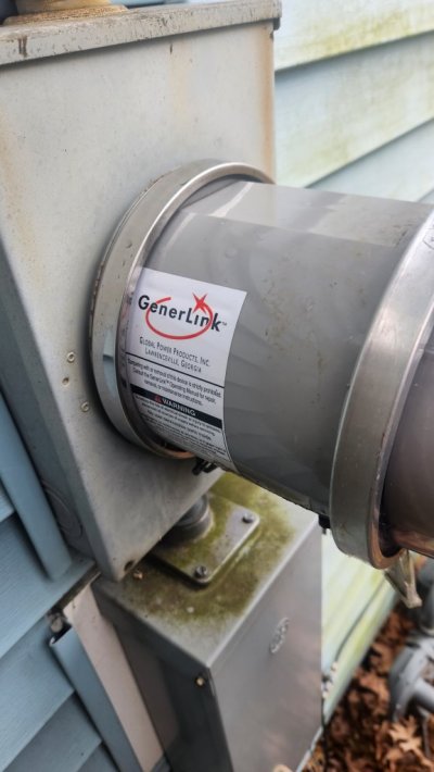

For what it's worth I use the GenerLink system for when I lose power at the house. It automatically cuts power from the pole when I plug into it and will stay on generator power until I unplug the cord from it. No need to trip breakers in the house at all. It's not the cheapest way but it is super easy. The unit cost me $1k install and that included a 40' proprietary generlink cable. The generator is separate (buy whatever generator you want) from that cost. The unit is approved by the utility company as long as an "approved" electrician hooks the unit to the house. My house isn't big so the 12k watt generator i have is more than enough to literally run everything in my house. I had it installed 2 years ago and only needed it once but it worked flawlessly. I don't know, just to give another option besides running your truck for hours. I attached a couple pics so you get the idea. The cord plugs in underneath the generlink where that lil black cap is

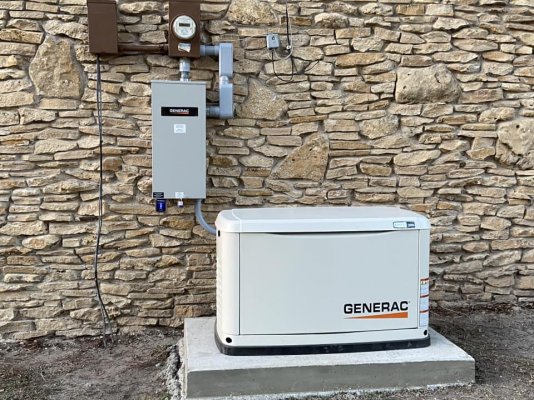

Wow, using your RAM to power house. I went this route instead. I guess OP could get FORD emblems and put on his RAM. :anitoof::33::owned:

They make generators to do that.

PS Turkeybird56, that is the same set up as the daughter has at her house, they have a sump pump that runs most of the time, so can't lose power. These run on Nat. Gas if you have it, the new ones can be controlled with a smart phone, I hear, but who runs the phone?
