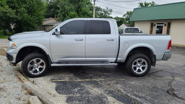

Here are some pics after doing a 1.5" Zone body lift, bilstein 5100s w/ eibach springs on the 3rd notch, freedom offroad UCAs and a 1.5" pro ryde coil spring spacer in the rear.
Ended up 41.5" upfront and 42.25" in the rear.

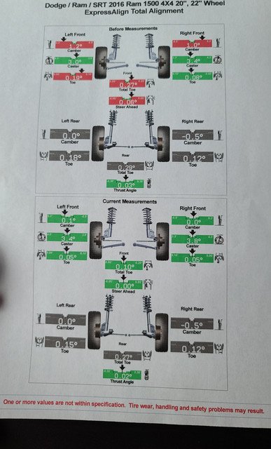

Also, alignment info - experts please feel free to chime in if something looks amiss but I think it all appeared really good from what I could tell.

Nice truck! I’m sitting on 5100’s with eibach springs at 3rd notch and 1.5 spacer in rear as well. I was thinking about. 1.5” body lift and you convinced me to do it. You do the body lift yourself? If so how was install?

Thanks guys!
The body lift wasn't terrible but it will take you and another 4-6 hrs if you're doing it on the ground like we did. For whatever reason the hardest part for me was the rear bumper but most complain about the bed spacers. After the 1st one, rest went in pretty easy. You will need a good jack and one 12" long 4x4 and one 28" long 4x4 so you can get the lift you need.

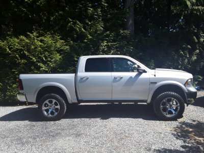

Here's mine with 1.5 Zone BL and Bilstein 6112's at 2.3 and Eibach 1" lift rear coils......
