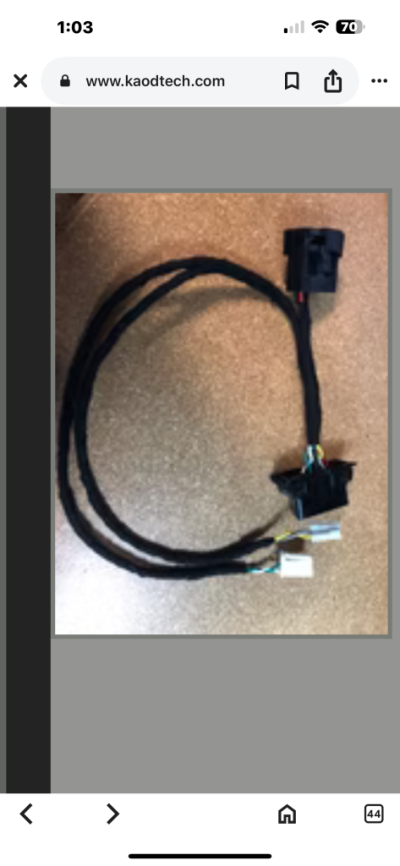

That does appear to be unusual looking. It's definitely different-looking than mine.
The one I have looks like the picture in post #2.

They make a good product and I know it can be tough to run a business and work a full time job at the same time, but I have seen multiple people have issues contacting Kaodtech with issues post-order. I personally tried to contact them multiple times to try to return a bypass and buy one for a different model when I ended up selling my truck right after buying the bypass and never received a response. Not their fault, but they do say they offer returns. Another member accidentally purchased the wrong year bypass and couldn't get ahold of them for a return, and now OP. I'm sure there have been more but that's what I've experienced.
@Jerryattricks I say all this because Kaodtech has been difficult to get ahold of from what I've seen. It's unfortunate as you received either an unfinished cable or something totally different since you dont even have an OBD port wired in to what you received. It should look like the picture shown on the website.

It's possible the website has a picture of an older version of the bypass cable.

I haven't been able to catch up directly with Deereguy (KaodTech) in awhile, but that doesn't look like something he makes/ sells IMO.
Looks like someone else's inline harness with some sort of module and relay on it? Not sure what that would be for? Is that one of @Brandon-w s 4x4 lock harnesses? ... AnC bypass? IDK
(Not saying you didn't buy one, but what's posted isn't one of his)

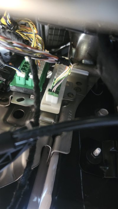

Well, sorry for the thread resurrection but the same thing has happened to me
However, I plugged the first connector in and do not have a slot anywhere for the second one..
Mine were not color coded either and now I have it just laying under my dash with one plugged in and one with no where to go...
I think I was sent the wrong harness.
Yes I emailed them a couple times now...
the green CAN bar has my new plug in it...
My other plug is WIDE, just like the first bottom slot being used in the white CAN bar
But the white CAN bar has no other wide slots for my 2nd plug (shown below)
You got the wrong one. The one you have is for a 1500 classic.
Just use it exactly how you have the one plugged in for now just to get you by. You will still be able to make changes to the body computer without the other one plugged in.
WOW...OKAY, THANKS.... that's good enough for me
YUP, worked perfectly
Sorry for my ignorance but that's why I support this site!!!!
Thanks Again Jimmy
