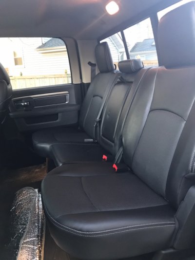

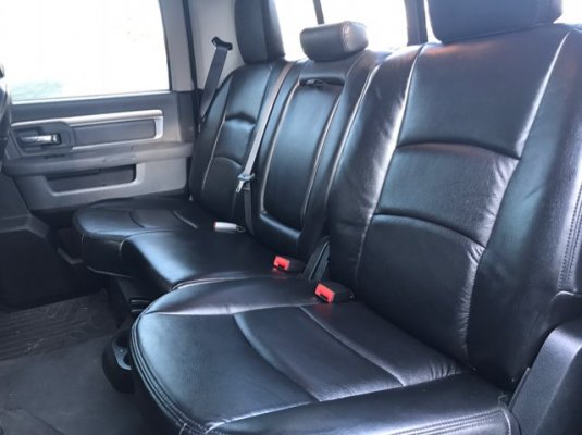

I'm trying to figure out if the actual back seat foam/shape in the Laramie and Big Horn Crew cab is the same? These front seats are out of a Wrecked Mega Cab so the back seats will not work in my truck. I am trying to see if the seats are the same so i can order the factory seat covers and cover my current cloth big horn seats so the leather matches these Laramie front seats
I understand what you're asking and the answer is no, they are not the same. Different foam. Could you possibly make it work, maybe. Top pic is my Big Horn rear in katzkin, bottom is my Laramie rear
outside of the pattern on the leather being different........they almost look the same. wow
It's close. The Big Horn has a couple more ribs in it. That's why I say you might be able to make it work. Also, and this may or may not make a difference but my Laramie rear is heated where the Big Horn isn't. Maybe someone with a non heated Laramie seat can chime in
