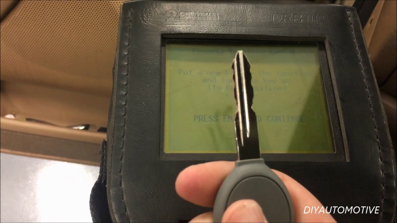

OK !!
I reread your original post on the subject.
Your Ram came with Transponder Keys
Transponder Keys are a sealed unit, with a computer chip inside of it
watch
