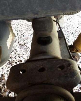

I used a Mcguaghy snub plate to mount the Tembren spring that I choose to suit my purpose. It can't get any simpler.
