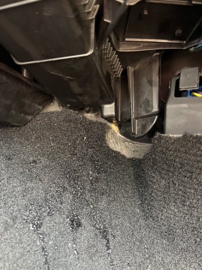

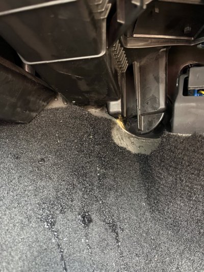

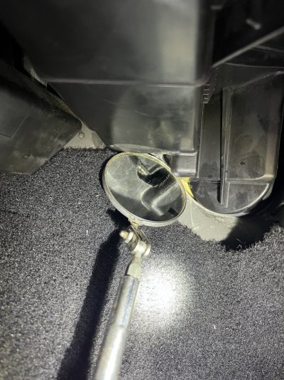

Purchased a 2020 Ram crew cab 1500 classic. Recently temperature increased outside and I'm using the air conditioning instead of rolling the window down. This started a bad rotten smell as the truck is parked. I located a leak on the floor of the front passenger seat. I then found a "hole" just as the condensor housing turned to go to the drain. I'll try to post a low res video if possible. Is there a good, workable fix for this curved location. I know first answer will be go back to the dealer but the dealer is in Southern New Jersey and I'm now in North Carolina. So the gasoline and missed work will be a high cost to go that route. I tried posting a 3GP (text message video) but it would not load.

If you have water leaking into the cab, turn the front wheel hard to the left, makes it easier to get to the condensate drain which is right above frame rail. Check that if it's plugged.

The water on the floor could be a plugged AC drain

If you can gain access to the hole. you can apply some sealant to it.... only if it is clean and dry.
