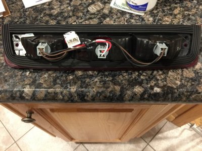

Well...had some nice 70 degree weather so I tackled the 3rd brake light mod...my truck had a tremendous amount of dirt around my light and was sealed against the truck pretty well...when I pulled away and disconnected was nice and clean inside....gasket was drying out and getting really brittle....it was also fairly thin...it was really glued onto the light and took me a good 30 mins to really clean and remove old gasket...had a thin layer of glue that once you heat up a bit you can rub off with your fingers. I then cleaned with goof off and then prepped with alcohol. I then installed the new gasket material which is very good quality. I also cleaned outside housing around truck with alcohol and then reinstalled the light. Take your time installing screws back as the gasket is thicker..be sure to balance the turns of screws on right and left to equal pressure...I will go back in a few days and retorq a bit one gasket forms a bit. Another great mod to be aware of as I am sure within a couple more years I would have had a leak as well....a lot of pollen, dirt, **** builds up in this spot as I was surprised. I am glad that it was addressed and new gasket warranted to 10 years...I also have enough left to do it again. I plan on keeping this vechicle and giving to my 6 year old son when he is ready to drive...be a great 1st vechicle for a young man!:happy107:

I did this mod to my 2017 when it was new before it leaked, I doubt your 2018 is any different

I did this on a 2017 for a buddy of mine (his was fresh, mine was hardened). I agree with above, it is very unlikely that they changed the design for 2018.

This stuff...
Black Extreme Temperature Auto & Marine EPDM Weatherstrip by MD Building 01033
5/16" thick, 19/32" wide.
My Wife drove my truck Sunday and called me Sunday night to tell me there was a light layer of mold on the seats. (I'm in the DC area and my Wife and my truck are in Florida.) I just ordered this product and will be installing it over the Labor Day weekend. Always something!

I knocked my 2016 out today - as others have stated gasket appeared in good shape but was a pain to clean off, it just disintegrated as I removed it, lots of scraping and cleanup time. Putting on the new 1033 gasket material was quick and easy though once I got it all cleaned up. It's definitely thicker, which makes the light appear to stick out a bit more than before, especially in the middle area away from the screws. But, it's the same material everyone else is using so I expect it will work fine.

Thanks to this thread, today I went ahead and did this to my ‘18 I bought in June. Gasket looked good but also didn’t want to take a chance on others misfortune of a wet headliner and more later on.

It won’t work on CHMSL - at least not on my 2018. I used silicone and sealed around the edges to avoid a future issue.

Burla's method worked great on my 2017 CHMSL
