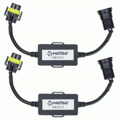

Metra makes these, find out what bulb is in there, this should plug in between factory harness and bulb. They make several variations.

They were working fine before so I suspect it's not the harness I'll need. One bulb still works fine, well actually both bulbs work fine, it's just a light out message I'm getting on one side and those harnesses weren't needed before - but I'll keep that in mind - thanks.

It's possible that there is a canbus adapter already installed or the led's bulbs are canbus compatible but the canbus adapter/compatibility has failed. Not uncommon for a adapter to fail kinda rare for the compatibility aspect to fail before a led chip. So the adapters listed could solve your issue. 2015 is not a good year for led's. FCA did something or increased the sensitivity to the canbus system that made led's hard to get working correctly.
yup, and those above keep from the "bulb out" code

If you don't see a random box in between the truck's harness and the headlight housing then it would be inside the housing. If you only see one box attached to the led headlights then the canbus adapter is built into the led driver. If you can find out what brand they are. Also another common way to get rid of the errors is to use resistors. They could be gold or blue. They'd be mounted outside of the headlight housing because they get hot.

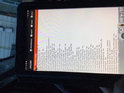

Chances are that one of the resistors is bad. Since you have alfaobd. Under body Control, car configuration, scroll down until you see CBC FEATURES-LED Front park, turn and enable those. Then turn the truck off for a minute, reconnect alfaobd, connect to the bcm, select the battery icon and read system id. And verify that the settings took. You may have to use each turn signal for about 20 seconds and the 4 ways after. This seems to help "force" learn the led's

I never got a chance to try this, but I did notice the parking light error only appear when I am signaling to the right. When the turn signal DRL’s are on in the daytime, there is no error. Should I still try your tip?

Yes. I had the same problem when I initially installed my switchbacks. I had only set the turns to led. Then set parking lights to led and no more errors

I changed the settings and it did not work. I still have that error code.

I changed 2 settings, CBC features LED turn signals and CBC features LED park lamps, then I cleared the code, went for a drive and left my turn signal on as that’s what triggered it, and ala kazaam, it’s gone! I’ll continue to monitor, but thanks for the help @1500ram12 , much appreciated!
