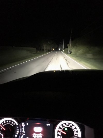

I’m questioning if his model year doesn’t have bi function projectors or if he doesn’t realize he has them. My projectors shield drops when the high beams turn on. So the low beam projector turns high beam along with the regular high beam bulb in the reflector (4 high beam bulbs total). My lights are insanely bright with high beams for that reason. If the later model years with projectors don’t have no function projectors I don’t think they can be flashed in because the proper hardware isn’t there. 27775c8621727b117ece6301d91cde75.jpgb911ba47bbfce9d6bded1d4924f8b584.jpg
The setting is there and now it's active. I deactivated the Bi-Xenon projector function accidentally when I was attempting to disable the dropout feature of my fog lights. "6 lights total"
As promised a couple 25ft wall shots
First is Low beam HID
