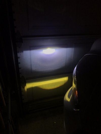

Yeah see your low beams are still shielded with the high beams on. Mine aren’t like that. When my high beams are on the shield drops. I’ll grab a pick for you real quick

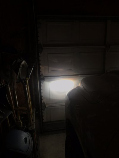

Its the auto enable high beam function. I can't get it to function properly. My high beams won't kick on. I have to pull lever to get them to light up.
I'll turn it off so I can turn the manual brightness on. It functions properly I promise you :D

This is the best I could do without pulling the truck out. Here’s my low and highs. I have 4 bulbs specifically for the highs. Notice the hot spot from the projector. Low means the hot spot significantly smaller with shield up then with the high beams on and the shield dropped the hot spot is huge. With a little extra light output from my to reflector bulbs.

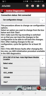

So long story short my sport truck has all the hardware to run the auto high beam enable function. However, it never worked coming off the dealer lot.
I have since purchased Alfaobd and enabled this function myself but for some reason the high beams won't kick on after enabling the auto function. I'm still missing a setting somewhere.
If i turn off the auto brightness and move the lever forward the brights/Lows kick on just like your photo.
Now if l can just figure out which setting I missed the truck can do it for me.

Here we go. This is the setting I need to fix.
My sensor connected to the rearview mirror.
Anyone which location this is for this module?
If I change it back to none I can manually turn the high beams on and I'll have the normal hotspot like your high beam photo.
Currently I have the wrong setting enabled so when I turn the brights on nothing happens except the display shows it's active and obviously by my pic it is not. Luckily I can reverse it.

Here is your pic with the lights behaving themselves. Pic is kinda crapp
Turned off the auto brights enabled :)
