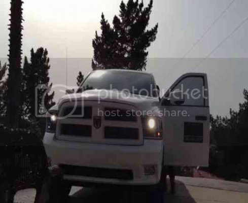

Well I had to order my fogs and a high diode for my truck so I figured I'd throw these in too, the package was coming anyway. The video doesn't do the change in quality justice they are sweet! Huge thanks to Jeremy as always.:banana-mario:th_blinkers.jpg
No hyper flash issues/light out notification with the resistors in. The video is short and not to great but a storm was blowing in.

Ummm........ they change colors... COOL! Where did you get those?

Wow... I mean, I love switchbacks n all, but that's rubbish for a blinker.
That's be super easy to over-look, especially during a bright sunny day.

to the OP, how do they look from the side? they look like they are just a beam out and dont really fill the cavity with light.

These shoot light directly out, nothing to "fill" the bowl there - which is great for most of my customers who paint the turn bowl anyway. ;)

Those seem awfully dangerous. Can you see them from the side? If not, isn't that illegal?
