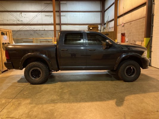

Do you have the Bilstein 4600s or the regular black twin tube shocks from the factory?
I am running the Eibach Front Coils on my truck with the Bilstein 4600s. Gained somewhere between 2.5-2.75 depending on how I measure. Paired that with some basic mevotech TTX control arms since I was rebuilding the front end.
I can pull hub to fender numbers later if you need to compare. My rear is lifted, but it measures close to a lot of the newer warlock specs IIRC. Pic to give you a visual reference.
