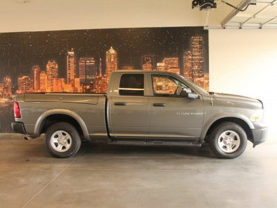

The ground wasn't level in the first pic. On perfectly level ground it looks perfect.

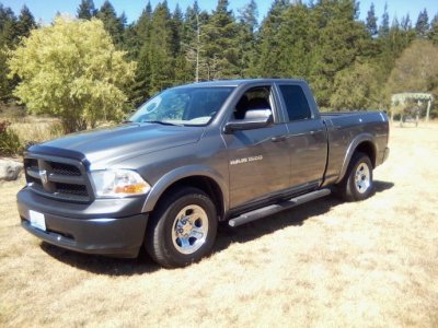

I have a 2012 1500 ST in Mineral Gray, with RamBox. Currently running stock basic P265/70R17's. I am planning on doing a DayStar 2.5" level kit (poly kit, no metal), but I definitely want to keep at least a little bit of rake. Hoping the results I get will be similar to yours. Also plan to upgrade to LT285/70R17's, or bigger if I can avoid any rub. Also mildly considering the full 2.5" DayStar lift... or maybe just the TGC .75" rear spacers with the 2.5" DayStar front kit. Recommendations would be great.
First pic is at the dealership on the day of purchase, second pic is in my yard. The front air dam actually rubs some curbs... unacceptable for a 4x4 truck. Other than that, LOVE IT!
