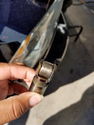

Monday I had what I believe a lifter fail causing a knock on the passenger side of the block. I stopped the truck and immediately had it towed to the dealer. Long story short, the lifter failure seems to be common with the Hemi's and the dealer claims it's unrepairable. Quoted me $11k for a new 5.7... Had the RAM towed back to my house and called a local shop that I've delt with in the past. The mechanic is working on a '14 RAM with the same issue! Owner had the same story as mine. Changed the oil, knocking started weeks later, dealer says new engine.
With that being said I'm looking to add a new cam and Hellcat lifters. I have a custom tune from Jay Greene and am leaning towards installing his Stage .5 HL v2 standard cam kit.
Has anyone had any experience with Jay's cams?

Picture is from the '14 the mechanic has ripped apart.

Any other pics of the can? Most of these have pitting or spalling on the noses of a few of the cam lobes.
Unfortunately no, that was from the mechanic to my salesman. I bought the truck on the condition that they fixed it all. They did the manifold bolt(s) too cause of course there was at least one of those broken lol. Hoping the engine got it out of its system now at 75K miles and this does not happen again.
