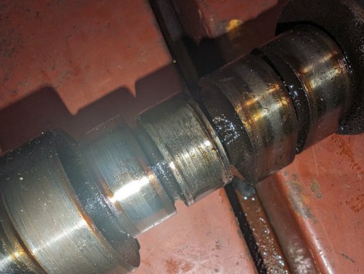

I am possibly doing a cam job on a 2012 2500 non mds I am able to get everything needed for the job. However rockauto now only has Enginetech lifters and they suck thats what i got in mine they fall apart and are noisy. What brand lifters have you guys been using? Should i just try to find a set of mopar or what? not much luck finding those either.

OEM Solid lifters.

Possibly doing a cam job? Meaning no mis fire yet?

Your local dealer should be able to get the OEM lifters.

Its 100% a cam missfires bad I just didnt want to commit to a job if i wasnt able to get decent also alot of places where out of stock and I hate enginetech.

Since it was a non mds truck just wound up using Enginetech they sound fine It will probably last until truck rots out everything else was just to over priced and inflated at the moment.
Good stuff glad you got it going again.
