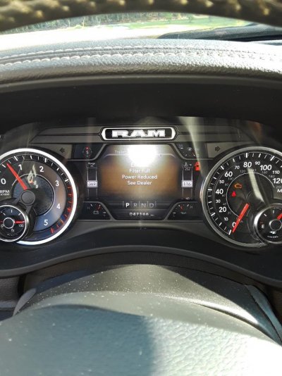

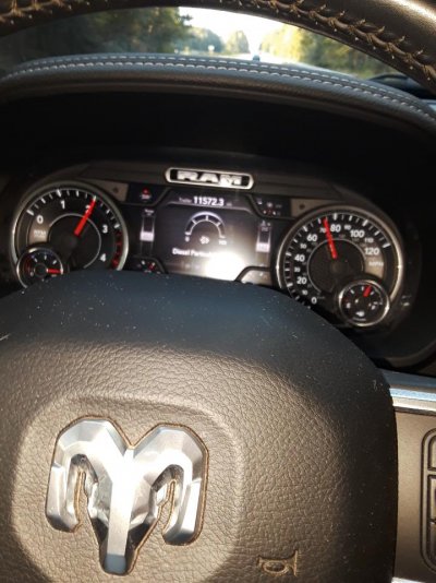

Dash photos.

Well good news. I started the truck up this morning to go to the dealer and about a mile down the road my warning screen turned to Regen in process keep driving. It took me about 40 mins to get to the dealer and the regen ran the entire time. Never had one go that long. usually they are about 15-20 mins.
I checked in and the mechanic was there and I told him what happened.
He said he would scan it quick and he cleared the code.
He said it tripped it because it said the exhaust temp was not hot enough to do the initial regen from Sunday.
That being weird since this morning the exhaust was definitely not hot when it went into regen.
The gauge is clear and stayed clear all the way back home.
Told him I am going to MD tomorrow for a 5hr one way trip and then turn around and head right back. There will be about 2 hrs of traffic light driving and the other 8 hrs will be 70-80mph highway. He said watch the gauge. So I will keep the gauge up for the trip and see how many times it goes into regen or how much the gauge goes up.
Didn't charge me anything for clearing the code.

Glad it worked out for you. I was going to suggest doing a stationary desoot using AlfaOBD. I am not 100% certain it will start the process of the DPF is already 100% full.
The regen going to the dealer was a long one. It did completely clear the filter according to the gauge (photo above). I ended up putting almost 120 miles on today after leaving the dealer and the DPF gauge has not budged off "0".
