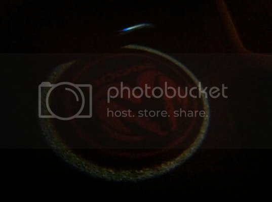

Ok, so a lot of you guys probably think these are kind of ricer, but I thought they were cool so I installed them and think they look cool.
The picture is horrible because of my cellphone camera at night, but the projected logo is bright and clear at night. I'd say the projected image is over 2 feet in diameter maybe 28"-30"
It's amazing how many people have come over to ask me about them when they see them lit up at night in a parking lot or wherever.
I have them tapped into the dome light circuit so they come on when I open the door.
Installed in the door panel:
The reason the white circle is a little off center is because of the angle of the door panel where they are mounted causing them not to be perfectly plumb in the door.

Its your truck do what you like! Where do they project to in the truck? The floor mats?
No, they project onto the ground when you open the door.

That looks pretty badass, can you let me know how you did that and how much it cost?
eBay from China. They were only $17.50
I tapped the dome light circuit and ran the wires through the rubber boot in the door. They come with a small hole saw.
I figured if they don't last I can just add a couple white LEDs. I have severe back problems and walk with a cane so a little light on the ground by the door is helpful. Kind of like puddle lights.

Where did you tap into the done light wire at? Is it easy to get to?
For my 2011, the dome light wire is in a connector behind the pop off cover on the end of the dash - Drives side
It's pin #13 Yellow wire with a white stripe
Pin #11 is ground - Black with tan stripe
