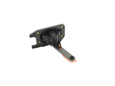

You are correct NVG271 however there does not seem to be any serviceable bushings available. See the attached doc for all available components. I think your gonna need the shifter assembly pictured below

Hi Paul,
You are correct and I just came across these notes from FCA which confirm it as well:
For grommet (bushing) at transfer case, order p/n 5080227AA lever. For grommet at shifter, must order shifter p/n 52105551AB.
