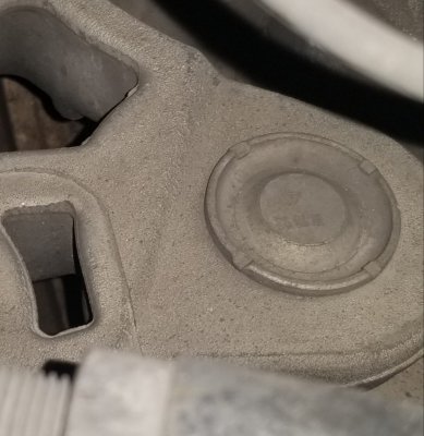

Looking to replace my lower ball joints on my 201320190219_191147.jpg 20190219_191147.jpg Ram 1500 2WD with a 5.7L, was wondering just what is this on the lower control arm covering the ball joint? Is it something that needs to be chiseled off or can it be removed in some other way. Can't seem to find any info on it. Any assistance would greatly appreciated.
Thanks
deangtp
Aug 13, 2014
208
63
It just pushes out. No need to do anything. It pushes out through the bottom. Top down
