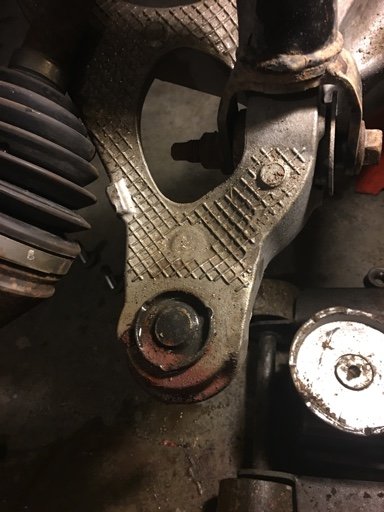

Not sure about the 2wd’s, but on the 4x4’s, you have to grind the “dimples” off of the ball joint before it can be pressed out of the lower control arm.
Here’s a pic showing the 3 dimples on my ‘12 4x4’s lower ball joints.
