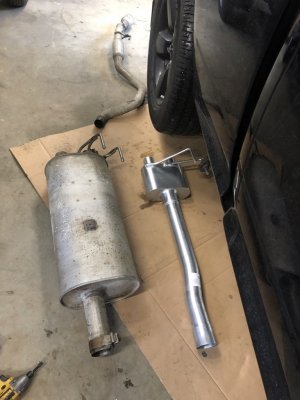

I have been looking for a direct swap muffler for a couple months now. After finding the usual magnaflow and flow masters for an insane 450$ by the time it gets across the border I stumbled upon a new company.
Lyell’s stainless out of Burlington Ontario. They have a few option for our trucks. A stainless direct fit muffler with aluminized steel outside, a full stainless, and a muffler delete. Along with a lot of other different components.
For $129.99 Canadian I couldn’t resist. Ordered it and received it the very next day! I even made a mistake on my order and they fixed that ASAP. Awesome service.
If I did it again I would have ordered the full stainless. However this one is fine.
It bolted up perfect, came with hangers and exhaust clamps, and sounds badass!
I would say it’s on the loud side of a muffler but by no means is it obnoxious. I’ve had magnaflows and flow masters and this is right on par with them.
Anyway, here are a couple videos. There is very minimal drone on highway of any- I really like it!
So there my review, buy local and for you Canadians here is a wicked cheap muffler that sounds great!

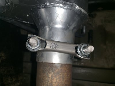

Howdy folks, I just installed this exhaust and while it seems fit well, the slip-on clamping seem like an afterthought unless I'm missing something. To keep my tail pipes from being able to freely rotate and slide around I had to basically crush the new pipes over the old ones with enough force on the provided clamps to deform the bridge pieces. I haven't fired it up yet but I can't see how this could NOT leak.
Am I missing something or was this your experience?

Just a quick follow-up, heard rattling today and despite crushing the large single pipe with the clamps, it still slides around and rattles. Avoid this exhaust unless you intend on having a shop weld it in, at which point the cost quickly reaches full cat-back.
Waste of money and time for me.

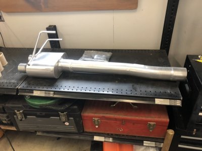

Installed the Lyell's muffler today. Drilled the clamps off the factory unit, ground down the factory clocking nubs on the three pipes and split the Lyell ends about 3/4" with a cutoff wheel.
Great sound but no drone on the highway! Overall very happy with the product.
One does have to have some basic fabrication tools.
