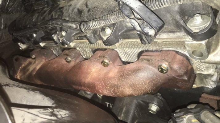

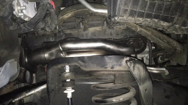

f9904271e3f0ae5c8c3cd656b972da27.jpg21a05c31d463fe09ac413ced3054877f.jpgf63c995ca30ad64f7ae7bd0b4200bdc9.jpga6dae5f184331a8cbc65e176edb346bb.jpgd5d833823ab0d28a220397ed39a9b5d7.jpg
Got the tick one afternoon when I went to start my truck to go on lunch. Ordered some JBA shorties since figured may as well upgrade while I’m there. Ran into clearance issues with the frame in my 15’ 2500 and had to send them back. Ended up doing grade 8 hardware and using a 6.1 Hemi gasket.

Just over 46k. Thought I had just broke 1, but actually had 2. The upper ones closest to the firewall on each side. Then I snapped one other one trying to take it out, totaling 3.
