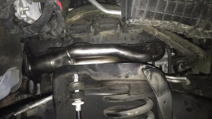

Got the tick one afternoon when I went to start my truck to go on lunch. Ordered some JBA shorties since figured may as well upgrade while I’m there. Ran into clearance issues with the frame in my 15’ 2500 and had to send them back. Ended up doing grade 8 hardware and using a 6.1 Hemi gasket.
Nice they look good , I just installed longtubes last weekend. No issues with the head bolts the hardest part was connecting the midpipe. Are you getting it tuned ?

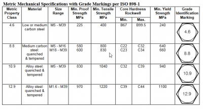

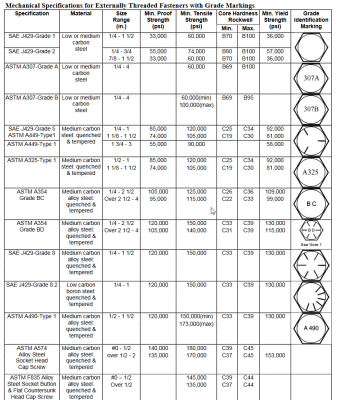

for those looking at those amazon fasteners, they are 8.8 metric aka equivalent to grade 5.
vs SAE

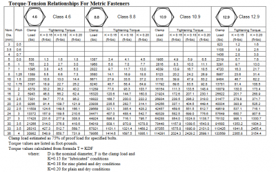

For those that were told there would be no math, min tensile strength 120,000 psi for grade 5 = 827.3 MPa IE really ******* close to 8.8.
You’ll need 16 M8-1.25x50 grade 8 bolts for the exhaust manifolds.
For those that are concerned about torque rating a M8 fastener. A 8.8 fastener is 18.8 ft lbs max. a 10.9 or grade 8 equivalent 26.9 ft lbs. Assuming you didn't put antisieze on it. Read subnotes on K if you did.
https://www.fastenal.com/content/documents/FastenalTechnicalReferenceGuide.pdf
All tables stolen from above link.
If you don't want to buy the stage 8 stuff ie Bolts Are Aircraft Quality Grade 8– 4130 Alloy Steel. Go to fastenal and pick up proper 10.9 or grade 8 bolts. Since its an M8, I'll bet you its 10.9 your looking for.

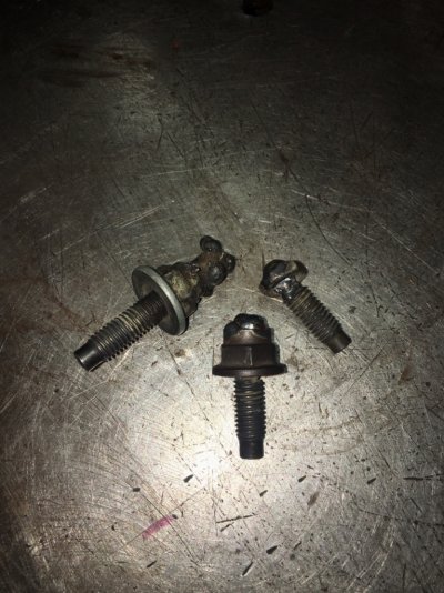

I have an 08 5.7 and two of the rear bolts are broken. I have only 110 k on my half ton. I live in the north east though that may be the whole problem with mine. I haven't attempted to repair yet. Do they come out easy, or is this going to be a drill and tap thing?
Cardhu
Apr 6, 2016
178
103
MB CAN
Its a water jacket is extremely close and weld on a nut on broken stud thing. couple videos on utube.
