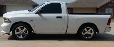

New pictures. I think the rear has finally settled in however the Spohn bars are squeaking again and it is real squirrely in the rear since I installed them.
This is very wrong. Something is wrong.
Did you get all the links or just the panhard bar?
They should have removed some of the slop of the factory setup!
