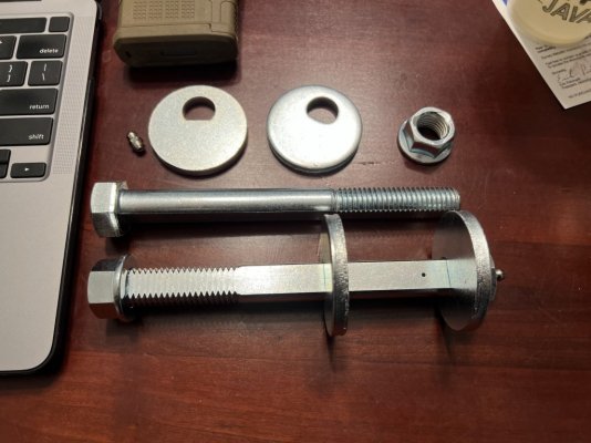

Has anyone tried Mevotech's lower control arm cam bolts? I picked up a pair to use on my rear bracket and comparing them to the new pair of OEM cam bolts I have, they are a bit different.
Main differences:
I'm considering using the new OEM hardware in the front bracket and the Mevotech in the rear. Am I taking a risk with the Mevotechs or will I be fine? Are these harder to dial camber/caster with?
Main differences:
mevotech | oem |
bolt is slotted for the entire length for the bolt | only the last inch before the threads is slotted |
both cam washers are discrete | cam washer and bolt head are integrated |
has zirks to inject grease and prevent seizing | no zirks |
tolerance between the cam washers and bolts are a bit liberal | tight fitting cam washers |
