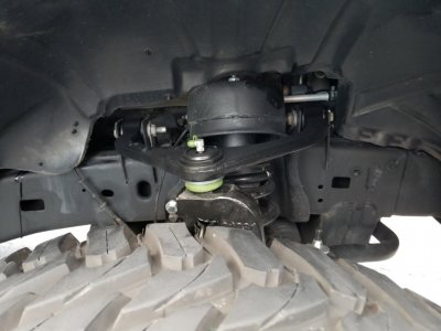

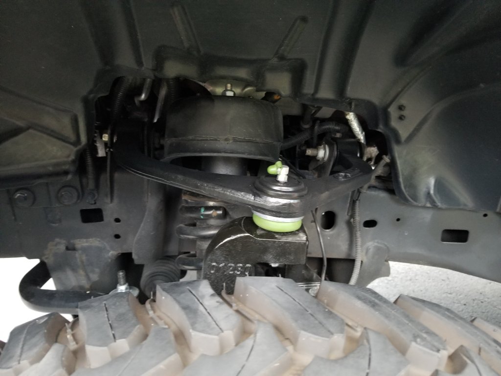

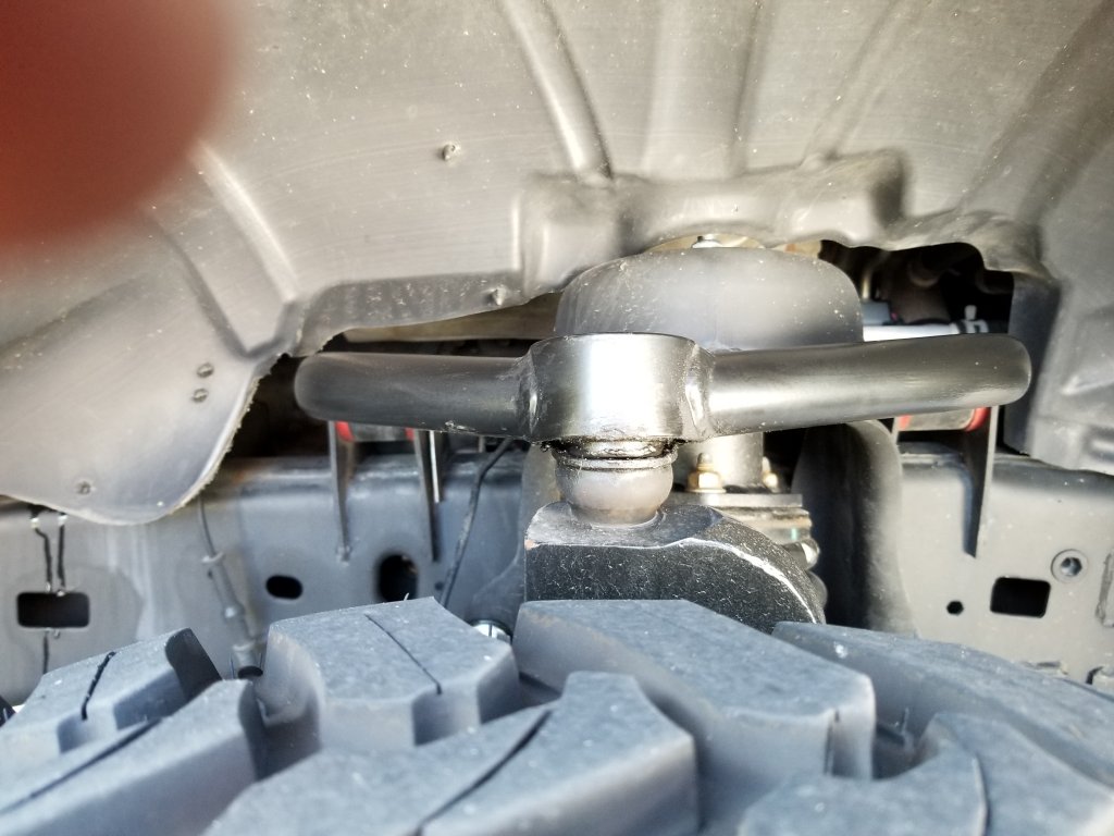

Well I finished up the yard work and it was still daylight so I tossed them on quick. I'm guessing the fit is the same as the standard mevotech arms which these were good basically everything you would expect in a replacement. Heavy arms looks like a strong joint though I can't speak on that yet. Either way they solved the problem they are in and ride as they should. First pics are the ready lifts you can clearly see the problem. Second 2 are the ttx's installed

looks great. pardon my ignorance as i'm learning bit by bit here, but why did the ready lifts not work and these did. i understand looking at them that they shouldn't be up like that but why wouldn't they work. what else was done that made them a bad solution for your vehicle? the type of lift? amount of lift?

They didnt work because the rl arms are camber corrected for ie angles different where the ball joint mounts for mild lifts levels or spacers. When I switched to the zone 6 inch lift the new knuckles are taller to keep a factory arm level where it should be so the RL arms pushed up the angle. The ttx are factory geometry which allowed it to sit properly instead of the extreme angle. And yes it will have to be aligned. Just not tonight
