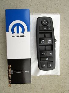

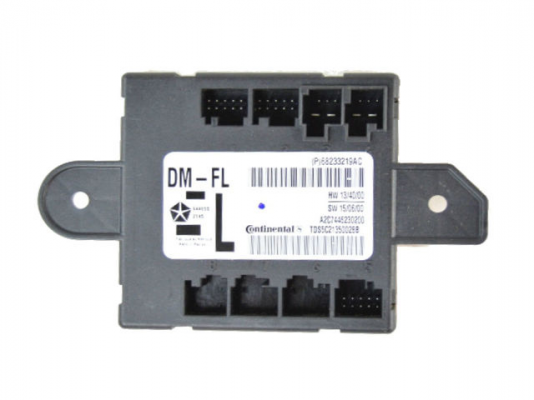

I have a broken mirror on my driver's side 2018 ram 1500. It's real basic. It does have defrost on the mirrors but they arent power fold. The question is if i replace both mirrors and the drivers side switch do you think the door supports power fold mirrors?

There's a thread on here somewhere about upgrading to power mirrors but I believe you would need two power fold mirrors, two control modules for the doors, a new window button thing (not sure what it's called) that goes in the door that has the mirror fold button and you would have to enable it with alphaodb.

2 door/mirror modules
1 Master Control door switch
Then a scan tool that allows programming or a dealership to program everything to work
