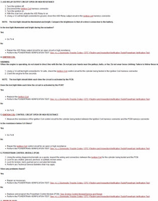

The code is P0306 Cylinder 6 misfire detected, both heads have been stripped, 3 new valves and all lapped in . Is there some sort of test to see if power is getting to the injector and spark plug ?
