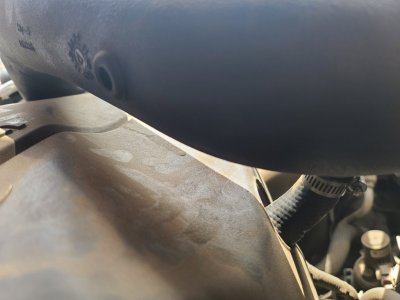

I had to replace the fuel pressure sensor on my truck last week, which required taking my K&N CAI off to get the engine cover off.
When reassembling i noticed a small inlet that had nothing connected to it, there was nothing disconnected, and I still get an intake air temp reading through my maestro and radio.
Is this supposed to be plugged? Left open? Or is there supposed to be a sensor installed there

I'll take one in a few when I change the filter itself. I have the tube that connects to the bottom, but on the back side of the pipe there's an open / unplugged hole. Will send photos in a bit.

That's in the wrong spot for the IAT sensor.
My guess is that's where the hose back to the purge valve should go.

Ok, better photo shows the hose inlet.
Odd place for the IAT, should always be just above the TB for accuracy.
Yes, it's missing & probably still attached to the plug & laying loose nearby. It should be installed IMO.

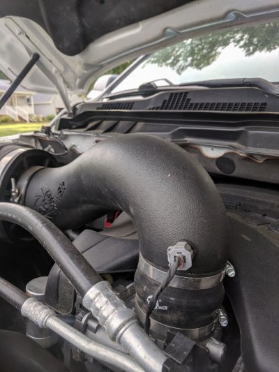

If you are concerned about air temps I would ditch that K&N........pulls air from engine bay instead of cool air from fender well or in front of radiator.
Thinking other factors like cooler engine bay vrs dirty filter dropped your temp if that Maestro is indeed giving you true readings.
My IAT sensor is 4 inch from TB on AFE filter intake......stock was about the same location.......you should be able to trace cable

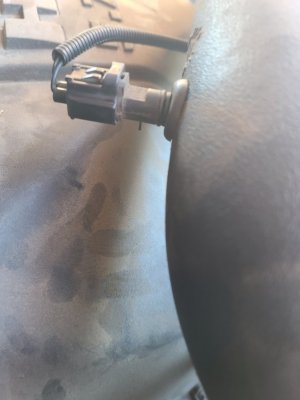

Well I found it, is this how it should be installed??
Edit- Looking at photos... i should be using a lot more pressure to push it in, was trying not to break it... i'll try to get it in all the way

To bad that hole was open to atmosphere, that means you got a lot of unfiltered air into your engine. Nothing you can do about it now... Your engine may run a little better now that it is getting more accurate intake temps.
