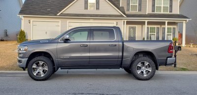

Just wanted to let everyone know I took the risk and had it done.
No issues at all. Truck sits wayyyyyy better.
I had called Rough Country twice and they told me no. Took it to 2 shops and they both said "it looks like it wont be an issue"
It works... have no fear.

It works, just be careful. It is essentially a better version of the Readylift 3.5" kit. However, if you do any offroad and your truck takes any punishment, your cv joints will be at much greater risk.

So what exactly is this suspension setup then? What is the “mopar 2”? 35x12.5 ko2’s?
Looks great!
