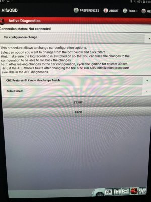

I would suggest using Alfaobd to program the Truck's BCM into having HID's installed.
Worked for me :)

RedSRT4Me
Oct 28, 2015
2,814
2,279
Scottsdale, Az
2015 CC Sport
I used:
Morimoto XB 4500K bulbs
Morimoto XB 35w ballasts
Morimoto ignitors
Morimoto LED 2stroke 2.0 high beams
Morimoto LED sealed fogs with Lamin-x yellow cover.
OBDLinkMX bluetooth adapter
Alfaobd software
No additional relays, harnesses, or resistors were needed or used.
Now if the end user wants 55w bulbs and ballasts I would highly recommend the mopar spec harness. I don't think the stock wiring can handle the larger output.
Rest of the truck runs JDMAstar led bulbs with zero bulb out errors.

RedSRT4Me
Oct 28, 2015
2,814
2,279
Scottsdale, Az
2015 CC Sport
Is this the only setting you enabled?
That was one of many.
I'll have to connect to the truck when I get out of work to send the latest settings to Google drive.
Off the top of my head
I enabled HID for the Low beam
Enabled Bi-Xenon for the low beams to function properly with the brights on.
Enabled LED for the fogs and other lighting

Oh wow ok, ya please let us know exactly what settings are needed just for the HIDs to work without the relay harness
