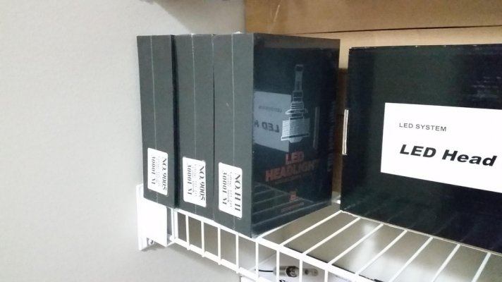

Any luck on the AM/FM radio issue? I have both 9005 and H11 versions of these LED bulbs, but haven't tested them on the Ram yet so they are not on our website.
