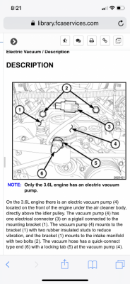

My 2013 Ram 1500, break vaccume pump. 5.7 location!!

Your 2013 truck does not have a electric vacuum pump. The 5th gen 2019 5.7 trucks do but not the 4th gen 5.7.Only the 3.6/3.0 fourth gen has one which is mounted to the front of the engine. You’re searching for something that doesn’t exist on your truck. I can guarantee you this, as an FCA tech for the past 10+ years.
If you have low manifold vacuum and all the hoses are good then it’s an engine issue. If it has an aftermarket cam this can lower vacuum as well.

It Does have the pump. I got the pump ordered from mopar with my Trucks vin number and motor number. Also if you actually look at the page i posted from the shop maunal it says right there 2013 and later 1500 models. Mopar uses vin number to verify fitment.. So who ever said it doesn't have one is wrong. Also my AC does have is lower funtion. You are right about it controling other funtions as well. Again.. I know this is the issue and it is for my truck. Just trying to see where it is. Please look threw the intire thread if your goong to comment because most of what people are saying i have alredy talked about or shown.. Thanks

I read through the entire thread. I saw your picture of the service manual, which that only applies to the 3.6/3.0. On the 3.6 the pump is located on the front of the engine underneath the air intake assembly which is what the manual is referring to.
Whoever sold you it didn’t do their job. I can look up parts through FCA and on your truck a vacuum pump is only available for the 3.6. It does not apply and is grayed out on the 5.7.
Look at your brake booster. It only has 1 hose going to it, which goes to the manifold port. If you had a vacuum pump the hose would have another port on it, that comes from the vacuum pump. If it had the pump all you would do is follow the hose.
Your HVAC system is completely electronic. The only thing the vacuum pump does on equipped trucks is keep proper vacuum present in the booster during high engine RPM which creates little vacuum. Due to the engine/variable cam timing of the 3.6 the pump is required.
Grab a scan tool and you’ll see you have no data for a vacuum pump like the 3.6 would.
Your truck does not have it. You can gut your truck all you want but you won’t find it.

Ill have the invoce with my vin on it so again thoes techs are wrong. The shop manual i puled that from is for the 5.7ltr... Im just going to find it my self i supose and show you guys when i do. Because when people havent hear of it or seen it before they assume its wrong. I know what im doing. Was just looking for advice on location... Sorry no one could help, thanks for all your guys responces any ways.

So all the factory parts information and factory service manual is wrong? You some how have a 1 of 1 5.7 truck that came with a vacuum pump?
You have zero proof that your truck has it. How do you think the vacuum pump is going to supply vacuum to the booster when there’s only one hose going to it from the intake manifold. You already replaced that hose and it only goes from the manifold to the booster. There’s only one port on the booster.
Are you sure your booster doesn’t have an internal leak? Do you know how to test the booster?
Have fun tearing your truck apart for nothing.
