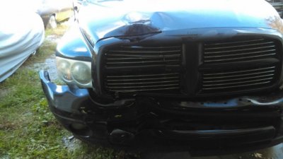

Thought I would post some pictures of my cheap truck , had dent in front , replaced hood an grill but need bumper,,has some rust needs fixed an other dings,,been straightening up interior as previous owner was hard on things but its coming together,,replaced fuel pump and tuned up with all new plugs an msd coils,was throwing misfire code constantly an would sputter out completely on long drives but after replacing ecm code went away an ran a little better but still have sputtering an loss of power up hills mostly ,of course about to replace 02 sensors an it may need cats so that's probably next and some duel tail pipes as previous owner cut muffler an tail pipe off,,, truck as had ball joints replaced before I bought it so that's good, an has 190,000 on truck but hemi was replaced with lower mileage motor and seems fine

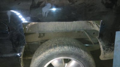

While waiting on blend doors to come in with dash pulled out,,I started fixing the quarter panels and cut out the rust ,, an order outer wheel housings and panel for fender well for both sides,,but thats all rust repair needed but do have some body work on passenger side to do

well got up this morning and while waiting on mail, I cut panel and added a lip all the way around with the flange tool an it also can add holes for quick welding,,still had to tack some on outside but very small welds ,,an with the new lip edge the welds are down in lip that it cuts way down on warping because of heat an grinding , took about 45 minutes or so and also have new outer wheel house in place and braces bolted on to hold until I weld more tomorrow as with the mail came other parts to start putting on new bumpers ,,but still waiting on one blend door before I can get dash back in which is delaying me,,it looks better than picture shows as it should feather out nice with some block sanding after adding filler ,, and still have other side to do and more body work on the cab on that side
