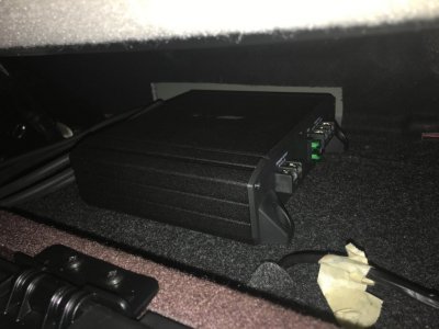

Ran the 8 gauge power wire tonight. Tried a few different ways but decided to just drill that clutch block Off plate on the firewall. Wire is run to the back and I mocked the Alpine MRV-M250 but putting 2 strips of Velcro on the bottom, sticks to the carpeted floor and holds it enough where it won’t slide around. Lots of room, and will let me pull the amp out easily (Velcro) to connect/disconnect amp wiring.

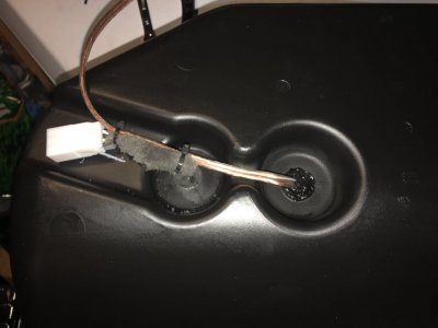

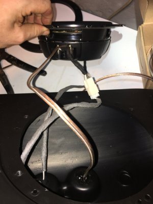

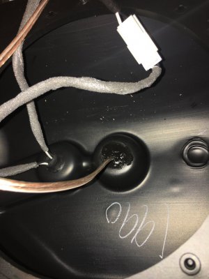

Finished everything up today. Pulled the stock sub to tap into the sub terminal for the LOC signal. Removed the sub, removed the bolt blockoff I put in and used a grommet with rtv for the speaker wire to go through. Tapped into one side of the DVC and ran it out over to the other side and connected both LOC channels to the wire as they are single channel. Set the amp gain to nominal and bass boost at 0. Sub hits a good bit harder than the stocker and this is with a new sub that still needs to be broken in.

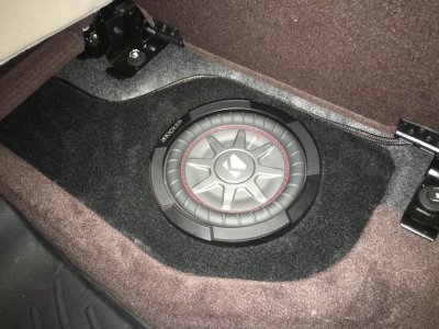

Hey guys. Decided to get myself an early xmass present. It was clear I was maxing out the pioneer 8” with 150-175rms and would hear it at higher volumes with the gain at NOM (1/2 way). I went on the search for a better 8” sub to handle the power while being shallow and fit the space. I thought I was cool with the JL 8” but that was also rated at 150rms. About 20min talking to crutchfield they confirmed that it would be around the same predicament I was in. They recommended a few but I decided on the kicker compact 8” shallow. It’s a dual 1ohm voice coil so wiring in the same as my pioneer would put me at 2 ohm which my amp can safely handle. This bumps power from 150-175rms @4ohm to 250-300rms @ 2 ohm. The kicker sub is rated for 300rms at its sweet spot so it would work well. Ordered and installed today. I also decided to add some polyfill to the boxes to help with the smaller box sizes (sticker and custom). I didn’t add a whole lot but stuffed the bottom and sides. Installed and had to Redrill the subs mounting holes and find hardware to fit. Crutchfield was priced the same as everywhere else as they had the kicker holiday sale saving $37 or something so the sub was $112 shipped. The pioneer was only $60 shipped, but if you ran the pioneer with 100-125rms it would be perfect!
Cranked it up and man it hits with another 150rms compared to before. I actually lowered bass on the stock eq to +1 and I’m letting the sub break in. But I had volume up to 28 with no distortion. My Sirius just ended a few days ago and I feel like the sound was louder before with satalite vs FM so it’s not Apple to Apple comparison. Seems like a nice improvement.
Side note the quality of the kicker sub is nice, heavier than the pioneer and it’s all once peice (grille is attached to the sub) but I was annoyed that kicker didn’t supply screws.
Pics of the new sub!
