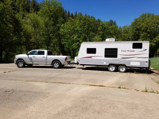

Bought this truck less than a month ago immediately leveled it and put new tires on. Took the camp trailer out this weekend and it towed great. though I didn't tow any super steep grades
Has 8 speed w/ 3:92 rear end, there was a bit of sag I'm still trying to decide if i want airbags or just a rear spacer
I like the stance without the trailer attached so I'm leaning toward airbags
I also might need to readjust my equalizer hitch.

With WDH set up right, you shouldn't have a sag.95ee004479a449cd0bece2d301906088.jpga56cdbc9f11e1c5402748da53b83acf0.jpg

That's what thought but I figured with the front level the back might be more prone to sagging. I'll have to try readjusting it. I had it set up for my old truck and just moved the ball down on the shank I didn't change the angle or adjust the height of the sway bar connector things.

Get a closer pic of the side profile of the hitch system... it looks like your ball might be too high, I say this lightly as it is only one picture but that sag is way too much for that setup from that pic.

Air bags all the way! Installed load lifter 5000 as I didn't like the ones that go inside the coil springs. Tow a 30ft enclosed trailer loaded no problem. Around 20psi in the bags and it's leveled. Well worth the money. Have 18k miles on them have yet to have a problem.
