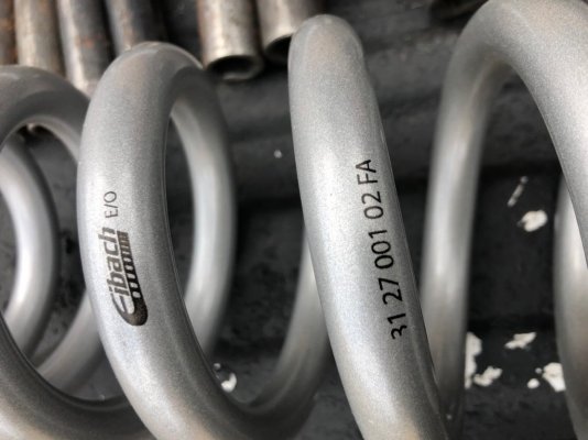

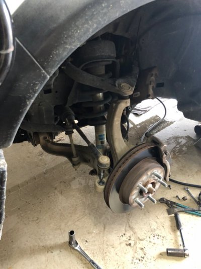

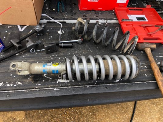

FINALLY got the Eibach Pro Lift springs installed... truck finally sits ALMOST level

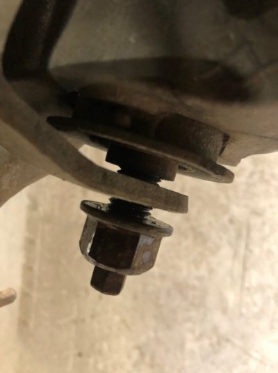

Started on the driver’s side to find out that the previous owner didn’t really pay attention when he installed the struts:
-Bottom strut bolt on drivers side with roughly 1/8” thread still showing between the but and strut body [emoji15]

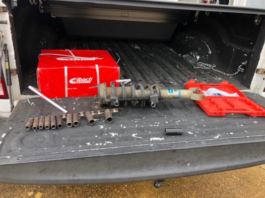

-out with the old... Buddy of mine lent me his F150, to make sure I could make trips back and forth till I got finished. Had to put the ‘Stang outside to make room in the garage.

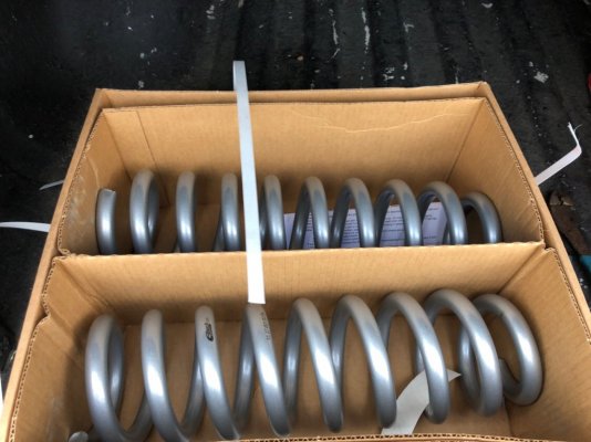

-In with the new!
Set at 3rd notch, and got me much closer to level:
LF: 38.5
LR: 38.5
RF: 38 5/8
RR: 39
I was worried I’d be adding a spacer to get the rear back up, but it appears that it won’t be an issue.

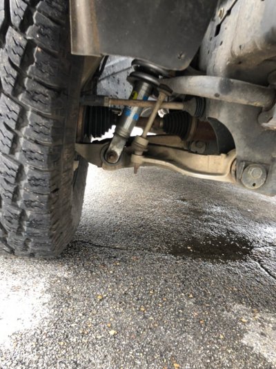

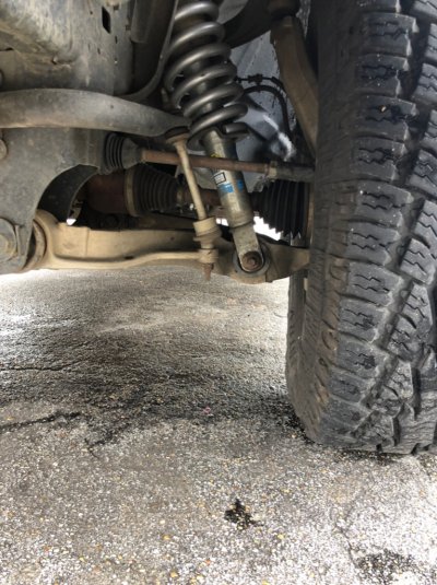

Obligatory CV/control arm angle pics - it’s been raining here, not a leaking truck, lol.
Weak strut/shock for the difference L/R??? What do you guys think?
