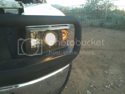

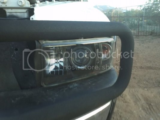

Well I got the headlights off of Craigslist for $70, thing is I plugged them in and the halos don't work and the high beam light is always on with I turn the lights. I don know what is going on with it...
There they are installed and looking pretty
And here they are on and working

You need to switch a pin around.
9004 and 9007 wiring is different, 2G Rams came with both depending on the year.

But they aren't HID yet... idk if it will still work?

Nvm, just reread the article, I'll try it tomorrow

Let me know if this "pin" corrects the problem gwolf. I just installed some after market halos myself and the rings will never turn off. (even though their on a closed switch:Wedgie:)

I changed the pins around and got the same result...
