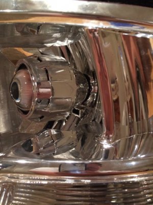

Well, I didn't realize you guys were on here. I started my retrofit a couple weeks ago. And I think I didn't too bad on my first attempt. I might need bigger shrouds.
I'm waiting to finish then lenses until I aim the projectors. I'll have them installed next weekend with a set of 5000k LEDs. Let me know what I can do better for my next truck or car I do.

I was thinking about it, so I plastidipped the chrome back, but I didn't really like it. I might pick up another set because when I trimmed down the inside to make the projector fit, I trimmed a little too much out of it.
Those are the mini Gatling gun shrouds, I think they are too small

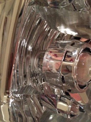

ImageUploadedByTapatalk1398556720.439550.jpgImageUploadedByTapatalk1398556742.869985.jpg
I finally got my phone charged to take clearer pictures of the side. Problem is I already have an appointment for next Saturday to have the LEDs installed.

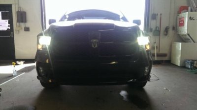

5000k LEDs. Using them instead of HIDs, they run cooler and take les power and won't flicker. Plus at $180 installed I can't beat the price
ImageUploadedByTapatalk1398741242.595206.jpgthat's the company's truck that I'm getting them installed by.

Well, good news and bad news. I got them installed today. And it took US about 2.5 hours. Turns out the morimotos only accept a certain H1 bulb. The LED bulbs I got were bigger. So, we grabbed a drill and make the hole bigger for the bulb to fit in. Then the wiring fun started. They are in now but I'll wait to post night pictures. Here's the picture of the box they came in ImageUploadedByTapatalk1399138339.498463.jpg

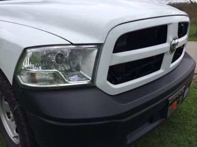

IImageUploadedByTapatalk1399142644.168856.jpg painted my grille as well. Now I'm going to have to get some sport bumpers too. ImageUploadedByTapatalk1399142692.701000.jpgit started raining so I pulled the front end into my parents garage

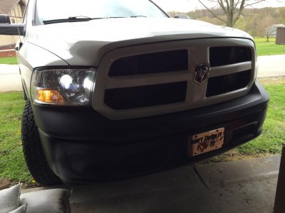

We'll tonight in the rain on the way home it was equivalent to stock. Which I am okay with. I'll take pictures when the rain clears up later this week.
