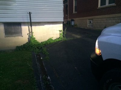

It make be because it was raining last night and everything was wet. I could see the blue on the exit signs probably 1/4 mile away. I also have a problem with blues, I didn't realize it was going to have a blue hue to it.
Or I could be making everything up in my head and the output really sucks. Either way I myself and happy with the outcome because I like the way the headlights look and that the retrofit worked. It was my first retrofit. In total I only spent $340 on everything. Which was cheaper than buying the other housings I was looking at. And then would have to buy the HIDs on top of the other cost. I was looking at racesports website. They want $250 without shipping for those LEDs.

From what I've seen with the led headlights,They are very picky about the housing.Ive seen them in some housings that are nice and bright,Then the same bulb setup in a different housing that was worse than stock.

By all means it fills the projector nicely. The camera just doesn't do it justice. I might be moving to HIDs, but I've been hearing nightmare stories about them flickering and messing up the electrical system
