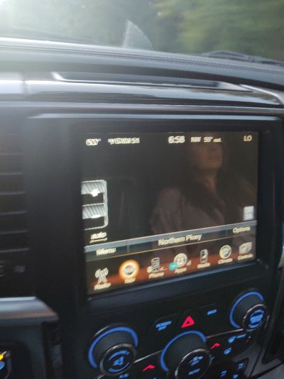

Update: nav has actually gotten worse now. Guaranteed to crash everytime. Tries the reset no improvement, except that it may get me back to the screen and start navigation again from the from screen below where it says "starting navigation". Below are pictures of what randomly occurs while using the nav. The last picture is of the dash cluster frozen on the nav when the nav isnt even working anymore???
I will try reinstalling thr latest firmware as it has it already. bb61c895d341f2b6a31aede9bcacca05.jpg883c0828524d936dbf5a3fb91c6f5d5f.jpg012a1128af9679f36927ef0401c4c4b5.jpg

How would that process work with you opening a case? I called uconnect today and they said the dealer had a dealer only update 99.99.99??? . I guess I will now have to pay a dealer to do this because I decided on purchasing the map update from them?
Or can I obtain this 99.99.99 update? I already did the 18.45.01 update myself on three of my vehicle with no issues, so im capable of doing this again with this 99.99.99

Hi,
I would recommend going into your local dealership to have them update your software.
Alison

So after all attempts to fix the unit since updates as advised by Uconnect and Here(developer of maps). Reinstalled firmware 18.45.01 - no change. Reinstalled map update - no change.
Called dealer $152 service charge for them to check amd do any dealer only updates they may have. I have to pay dealer and they seek reimbursement from UCONNECT or HERE. Next week I bring it in for the day.

My guess is that it's just an internal service bulletin reference to the v18.45.01 update and they won't be able to actually do anything other than to say yep, it's broke, you need a new radio. $1000 please. (Used ones are $400-$600).
Maybe if they look at it, they can get it replaced/covered by uConnect/Here since the update got it screwy.

Yep....Ill have to dig through really old emails, but IIRC someone told me that 99.99 is an internal numbering when an update is "about to come out" but its not publicly released. Thats what the 18.45.01 looked like in the system before it came out....my guess is 99.99 is still referring to the 18.45.01
As far as the issue in this thread, I kinda wonder if its another manifestation of a bad sierra card.
EDIT: ran my update check script, there does not seem to be any new updates since October of 2019.
