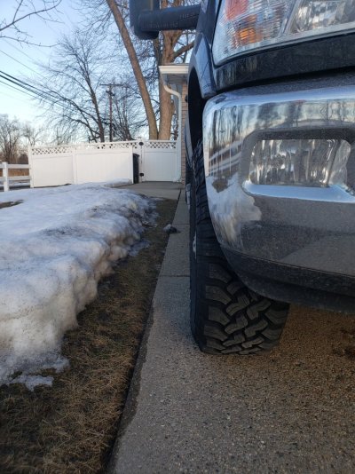

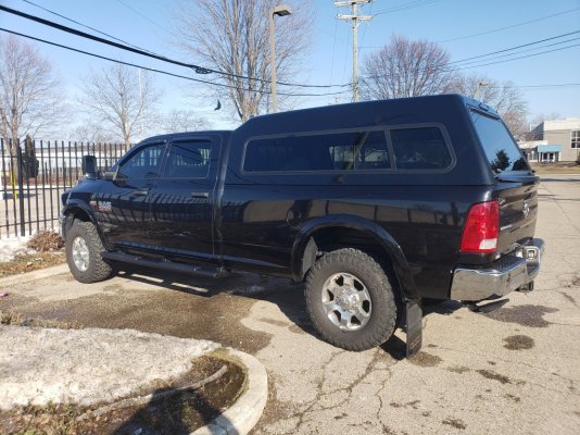

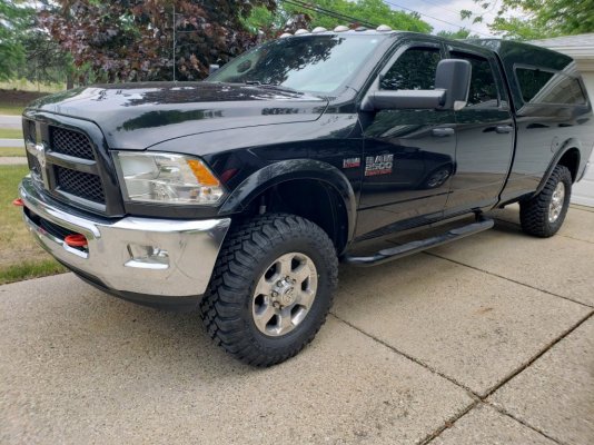

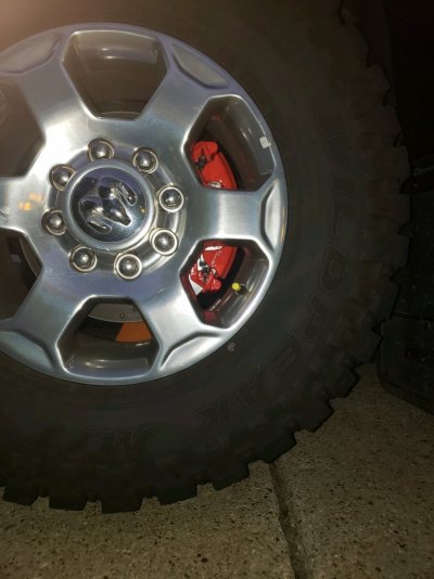

Hello J, 35x12.5 should work without needing a lift. I have a "16" 2500 with springs all around. I installed a RC leveling kit up front.
I run Wildpeak M/T 35x12.5 on 18 inch factory rims with just the slightest rub on the front trailing arms at full lock and the front suspension compressing.
