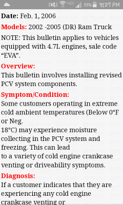

**** I hate computers, that’s not what I wanted to show, well it is but not like that sorry, let me try again, it may take a bit.

I’ve seen that already... but I wish there was a parts one!ci emailed Dodge, so they should get back to me tomorrow. I’ll check in to see if you found the other part

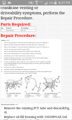

You just need that adapter, 05191104AA google that part number and a bunch of places have it, even amazon lol.

Is this the part you’re talking about? I’ve read that it says I need the filler tube with no pcv, a new hose, an adapter etc.
There might be something I’m just not picking up on though...

The adapter is the main part, everything else you can plumb yourself, the fill can be plugged to if you don’t want to buy a new one but with all that you will be good to go brother. But still change that oil.

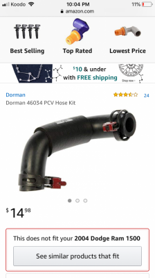

Cool.. thank you very much guys. Anyone have a picture of what that adapter actually looks like? Just want to make sure I get the right thing.

This is the adapter, but I’m not seeing any part numbers or where to get it.
I’ve been searching everywhere since and can’t find that adapter for you, wtf!!! I don’t even know what to say man but I’m sorry, I can’t find it. They have the technical bulletin for it but no parts! I’ll keep looking bud.
