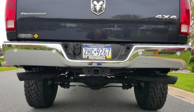

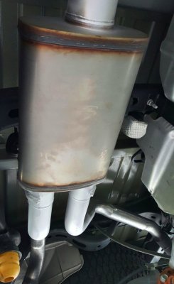

If you are going to add dual exhaust you can do just about anything, just find a good shop and they can make it happen, I had dual added , one each side
attachment.php
attachment.php
