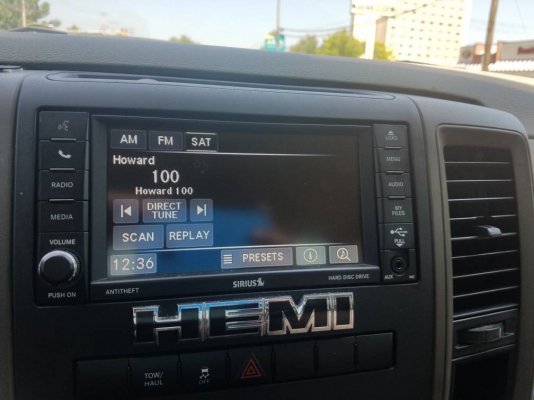

The OEM RBZ/RHR/REN touchscreen radios don't require any cutting, any adapters on harnesses. They just plug right in, bolt right up, look amazing because they are oem and have tons and tons of features. And they cost way less then most 6.5" touchscreen with similar features.
