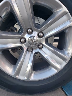

Just put my powerstop z36 pads and rotors on all corners. Used the kits on my prior f150 as well. Great brakes. Be sure to follow the break in/ bedding procedure. With current rebate I could get it for only like $50 more than Wagner OEX setup so I went this way. Plus I live in IL and this is a local company located in Bedford Park so I get to feel good supporting a local company.
