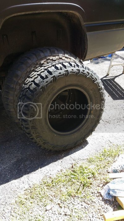

Yup, I do most,if not of all my own work. I'll take some pics today
Harleygtp
Harleygtp
Aug 17, 2015
91
23
1995
Cummins 12v
20150826_105303_zps2nwkwdq7.jpg~original
Johnn123
Sep 23, 2013
2,090
1,099
Ontario
2010
Looking good man! My buddy has a set of those Trac-Grips theyre nice tires!

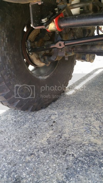

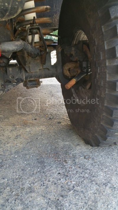

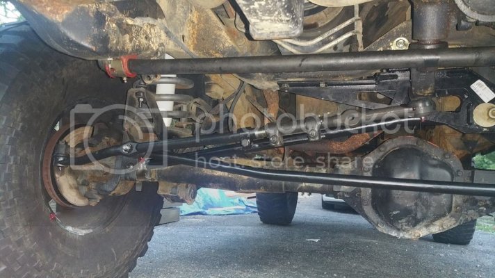

Good day today, got the sj track bar in, all the drag links and tie rods replaced, sway bar end links replaced, sway bar drop brackets removed and links flipped, everything was hit with fresh grease.
Now just waiting for my dor order and I'll swap out this steering box!
I'll post pictures later.
