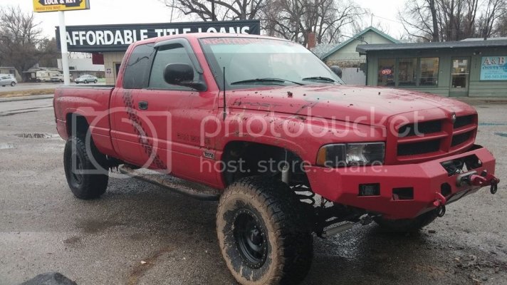

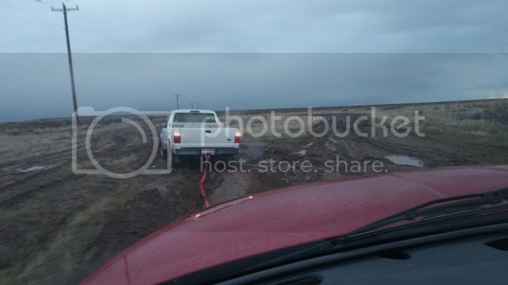

Had my first recovery this morning with the truck. With my work being a 4x4 shop, we get usually at least 1-2 phone calls a week during the winter from people stuck in the snow. At times theres pretty extreme recoveries, and tow companies never want to risk taking their trucks up there and actually have started giving our number out. Normally I'll post it on our off road groups facebook account and get a couple different rigs going, but with the small amount of snow we've had this season we've had no recovery calls, until this morning.
Co-worker headed in to work early to work on some things, got a phone call from a young kid. Took his info, called me and I went out to help before heading into work.
Young kid in a 2wd single cab long bed ranger. Went out to play in the mud alone, got stuck at 3am and had no one to help. Called a tow company, was quoted $1500 to come pull him out. He wanted me to use my winch, apparently he had a bad experience using a strap and started getting annoyed with me, but with how slick and gooey the mud was I couldn't see the winch working. Would have just dragged my truck rather than pull him out. Threw the strap on, two tugs and less than 5 minutes later I had him back on pavement and on his way.
Luckily it rained pretty hard and took most of the mud off on my way into work, so minimal cleaning tonight. Made a little money off the deal as well, enough to cover gas and the time to clean the truck.
Looking forward to using this truck for snow wheeling and recoveries.
Also had some good times last night. Got to meet Scott from ARB as he rolled into town, talked for quite some time. Wound up on the subject of my bumper on my truck, and I told him the pros and cons to it. The more I spoke with him and told him about the cons, the more I started feeling regretful for going with the bumper. Nothing really fit "quite right" and everything, including the mounting brackets and winch mount, is made from 3/16th metal. A 12k winch on a full size truck is bound to break something bumper wise with my setup.
The ARB incorporates things that other bumper companies don't, and I had never given it much thought until Scott started pointing things out. For example: the ARB mounting brackets include some crush (or crumple) zones, so in case of a smaller impact, it won't deploy the air bags in the truck.
So, Monday when he's back in his office we're going to go over price options for an ARB for my truck. Once the bumper gets here, I'm thinking I'll have the bumper stripped and painted/powder coated red, and the bull bar changed from chrome to black. I swapped the Rigid SAE fogs onto my bumper about a week ago, so I can just get the Rigid round adapters and install them on the ARB, and the two 9" LED's I have coming on Monday actually look identical to the ARB 9" Intensity lights. So I already have everything for the ARB to work on the truck. Thinking I'll yank the Move and install the ARB, then give the Move to my brother for his truck and he can either spend the time with a grinder taking all the Raptor Liner off and then I can help him paint the bumper white, or he can pay to have it blasted and powder coated.
Regardless of price it's going to happen, price point just depicts whether or not it will be sooner or later, or if it will go on as is or color matched to the truck.

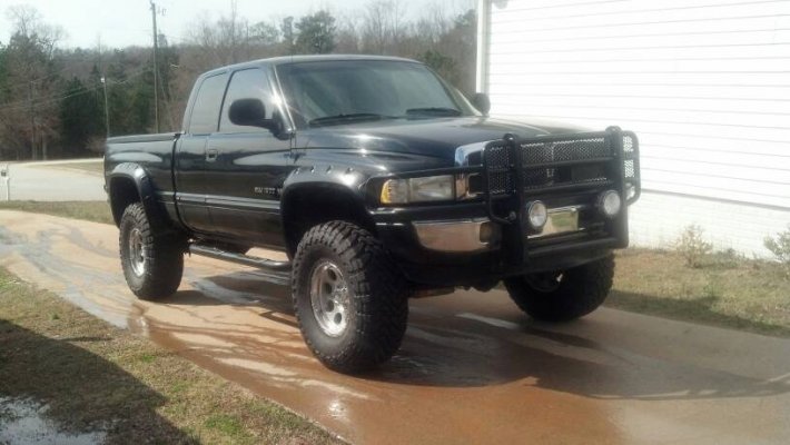

I looked at that arb bumper and I honestly think the move bumper works well with your truck, maybe better than the arb bumper. Forgive me since I haven't messed with either bumper I don't have any experience, but while the move bumper may not be of as good quality as the arb, I think it's style suits your build much more than the arb. Since the move bumper is diy would it not make marketing sense to actually modify it? You say you also use the truck to advertise for your shop basically, I do not believe modifying a diy bumper would be too far removed from the type of audience targeting your aiming for; Modifications like winch bracing and maybe swapping bumper mounts for the superior arb mounts.
Sorry if it seems I'm missing the point but I can't tell you how much I like that bumper on your truck; it suits the entire build.
On a side note, do you still have your original bumper?

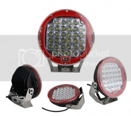

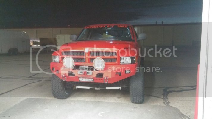

Lights showed up at 5pm today. Thanks Fedex. Gonna get them wired in eventually, but they look *******.

Can I be honest? I don't like them, not even a little bit. They would look better behind the grille. Truck looks good though. Lol

I like them. A lot. If they weren't so expensive I'd buy them to replace my round lights. I wish mine were bigger 11b07e1ff909ef26e88c800665a948f6.jpg I liked the look of the bigger lights like I used to have 4ef7a3377bb2273096683709aa1842e8.jpg but leds are so much better
Pics of the light output??
I'm actually thinking about where I'm going to put them right now for a permanent location. I'm not going behind the grille, as my plans for the bumper will interfere with anything behind the grille.
Talked to ARB yesterday and I can't get a deal good enough to go with their bumper. By the time I pay shipping and everything, I'm shy of a couple hundred bucks to go with the TrailReady bumper that's designed for the sport model truck.
So I'm going to do the mods to the front bumper I was talking about. The lights I have are going to go along with the prerunner bar I'm going to install, whether they stay where they are and the bar goes slightly over them, or on top of the bar with a 20" light bar fixed into the opening in the bumper. I've decided regardless I'm not going to dink around with the openings that are already there, just going to get these Duallys to fit in there correctly. Then I'll work on a skid plate that ties into an oil pan skid and respray the bumper, and call it done.
I'm going to do the Sport clip trade for my brother's black grille on his truck, then probably build and install a custom insert that will set the truck off from everything. This will all happen probably around tax season when I can afford to buy my hood and some flares, still not 100% positive on what flares I'm going with but I do know I want them painted to match the truck. Might as well paint everything all at once, and contemplating spraying the whole truck to fix some spots and start over with my graphics and change it up a bit.
I'll get some pics when I get them wired up. Tomorrow night I'll be wiring in the 9" spots, the Rigid Dually floods, and install plus wire up the tow mirrors that came in yesterday. I'll be wiring up the signals in the mirrors as running lights.
For now here's a better picture of it in daylight. I love the way it looks.

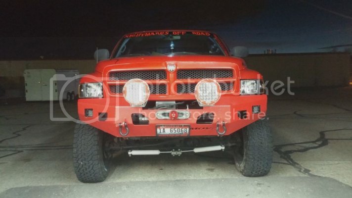

I'm going to have 3 pairs of lights. The two on the outside of the bumper right now are the Rigid SAE fog lights, I have those wired into the factory fog light switch. I'm going to install the Dually floods in the inside holes of the bumper, and wire those to a switch. Then the 9" will also be wired to another switch.
I'm actually planning on using the housings I had on it before and modifying them. Going to replicate this.
Planning on another set of the SAE's so I'll have two pairs total. One for headlights, the other as "fog lights" even though they're the same exact light. The SAE's are 100% street legal fog lights, but they're equal in brightness to my headlights. I am easily able to run them at night without the headlights on and see just as well, but for whatever stupid reason cops pull people over if they're headlights aren't on. So I'm going to do the SAE's as low beam, then do a set of spots on the inside and wire those to the high beams. Then move my Putco switchbacks into those housings and seal everything up. Then the bumper will have the SAE's again, the Dually floods, and the 9" lights. Super excited for this modification, should be ******* when done.

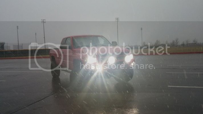

Had a good day with the truck yesterday. Got the tow mirrors installed, then the Dually's from Rigid and the 9" lights wired in. The floods I can hardly tell when they're on, a little disappointed but I guess with the amount of light I have I shouldn't be surprised that they get washed out. When the headlights are on, I can tell when the floods are on, but with the headlights and SAE's on, I can't tell. The 9" spots however, all I can say is wow. The pictures I have do absolutely no justice, being in the open plains obviously didn't help, but while on the back roads heading out there last night I could see the stop sign reflecting back at me when I was about a mile away still.
After installing and wiring everything up, I headed out to do a recovery last night. Young kid went out with his 2 wheel drive chevy on Monday and got it stuck in the mud. Couple hard tugs got him out, then kept the strap on and dragged him back to the pavement.

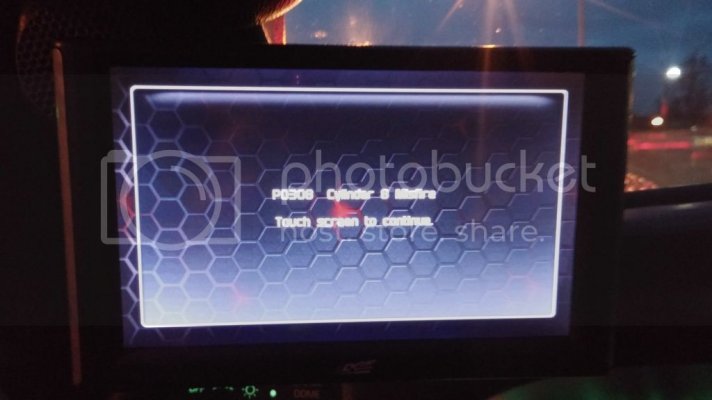

Not sure exactly what happened, but after that run I started running into issues with the truck, then they magically disappeared this morning for the time being.
Sunday morning it felt like the truck was idling a little on the rough side, but as the day went through it seemed to be clearing whatever issue it was having on its own.
Yesterday morning when I started it to let it warm up, I noticed from inside my home the idle seemed off. Sounded like it was idling super high. When I got outside with my kids, the idle started to jump every couple seconds or so, almost as if it had a kick down like an old carbed engine that wasn't performing correctly. As soon as I put it in gear, it went away. I parked it at the daycare and let it idle outside, immediately it started jumping idle again. By the time I got back outside from dropping my kids off, it was sitting at 1200 rpm while idling, then dropped back down once again as soon as I put it in gear. While driving or in gear, it acted 100% normal.
Last night when I fired it up to leave, it started doing the same thing. High idle, or jumping idle, then as I went to pull out of my work it threw a check engine light.
Misfire on cylinder 8. When I would come to stop lights, the idle was rough and it was missing like a *****. Every couple of seconds you'd feel it, along with idle jumping up and down. As soon as I would take off from the stop light, everything was normal again. Again and again it did the same thing through all the stop lights until I made it home last night, never cleared up.
Now, weird thing, this morning everything was 100% normal. Started it to let it warm up, check engine light was still on but no weird idle, no miss, nothing abnormal. Around 10 minutes later I had my kids outside, buckled them in, then when I got in the drivers seat the check engine light was off. Code was still stored, so I shut it off, cleared the code, and fired it back up. Ran perfect all morning, when I got to work I checked for codes again and nothing is there.
It was suggested that it could be the IAC, so if the symptoms return I'll start there. Otherwise, hopefully it was just some water or mud from Saturday night that cleared itself out.
