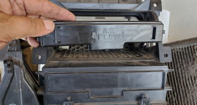

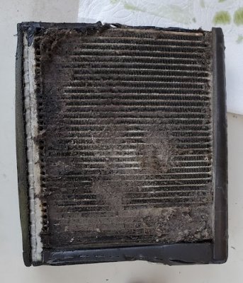

There are several posts about adding the cabin air filter. I added one to my 2009 when I had the dash out to fix the evaporator. You can see below how clogged up the evaporator was. It was easy to do and can be done without taking the dash out. You just cut out a rectangular hole where it is marked on the box, insert filter and pop on the cover. I got the cover and K&N filter from Amazon.
Cover - https://amzn.to/3fOZDFC
Filter - https://amzn.to/3oWTmMa

Mine I am assuming is a late build 2016 and did have the compartment with the cover installed. Airflow direction indicated on the cover.
I purchased a new filter for my truck without even looking to see if mine was dirty. That’s when I found out a filter was never installed.
I hope it helps with the dust that collects on the vent fins.

Should help. I live in a very dusty area and the cars without filters are definitely worse in that regard.
